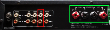

I am getting a repaired nad C315bee in a decent price but will it be possible to use it as a power amp for Atmos channel..if I can, how will be the connection please?
Hence it's Nad I am little interested
Do i need to connect the rca from pre out from my avr am230 mdc card as below and connect to integrated amp aux rca connection. correct me if I am wrong.
Nadt758v3 am230 mdc card pre-out
Nad C315bee Aux port. connect the atmos speaker on speaker terminal
and select the Aux switch.
thanks
Monotosh
Looks to me like you don't have a HT Bypass in your integrated amp. So if you connect it like this, you will get a lot of noise. My suggestion is that you get yourself a power amp to suit your requirements.
