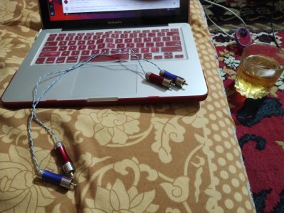

Rather me enjoying Blue and Red Connectors and wires and craftsmanship during building it , for me treat to eyes was, the pale yellow side glass.:)
