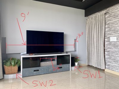

Few aspects were missed out by me while laying down the constraints.
The wall where the front speakers would be installed, doesn’t have 13’ width (Room width). That is due to a door on front edge. Considering space for 120” projection there is space just enough for 7” wide FL and FR speakers. That is the reason I didn’t consider tower speakers which would have provided much better sound than the ones I have shortlisted.
Moreover the maximum width of centre channel has to be less than 24”. While designing the cabinet I had presumed that 24” should be adequate for decent centre ch speakers.
Since the C,FL and FR have very limited available depth I couldn’t consider rear ported speakers. Now, I could be wrong in this aspect but my understanding is that the rear ported speakers would need to be kept a little away from the rear wall.
I am attaching a picture below that clears these aspects.
Haha, you have made the problem, how do I put it, very interesting. :D
Jokes apart, I run the Monitor Audio Radius 225 LCRs.
They are 24" x 5.5" and have a decent cabinet depth too (2.75").
you can see my temporary set-up here:
If you get a chance, give them a listen. There are a couple of capable surrounds in the Radius 45 cubes and the Radius 90 bookshelves, too...
Alternatively, you could try and accommodate some slim FS + Sub in the spaces you have marked for Subs...

Depth and length is not a problem. It is only the width that is most critical. Sure will look at Monitor Radius ones. How are they compared to Paradigm Cinema 200s. Price and performance wise? For centre channel I guess Paradigm 500C would be better than monitor one’s. For L and R I would definitely reconsider.
SVS 1000 pro dimensions are one of the smallest for 12” SWs. There would be a little spare space left in that area if I go for 1000pro. I can place Fs there but then they would be lower than the ear level in seated position. I had planned that area marked in the pic above for L and R.
If I put them at lower level then would that be ok? If yes than I can put decent quality bookshelf ones right next to Subs.

But on looking at the pic again, I am wondering if you could not convince the people at home to place a good pair of FLs on the floor in front of the area marked SW1 and SW2.
Logic being: Isn't it better to buy the best speakers your money can get you, for the space you have, instead of imposing these restrictions on yourself?
Of course, you might find a competent slim, front ported FL (again offering you an MA option, though I assure you I have no vested interests :D -- like the Radius 270s, nothing beats a full blooded tower, especially for a 2000+ cu-ft room, which from the picture opens on to other spaces, meaning the the area you need to take to calculate is even higher...

Few decent ones are DT procentre 2000, Polk audio reserve R300 and Oberon Vokal (front ported).
What would be the issue in this? Is it workable?
Did some legwork and got to audition a home theatre based on B&W bookshelves and Centre paired with Bose dual 10” SW. B&W ones were 606S2 and HTM 6S2. I found the setup to be very impressive. I found it to be better than Emotiva C2+ based system. Also checked Bose professional FS5Se and FS4SE in stereo setup. They were also very good with a lot of clarity and detail. Seriously considering them for surround and FL n FR if nothing else meets the requirements.
If you didn't like the Emotivas, then Vokal for sure.
But while there are many FMs happy with their Vokal, there are a few who have moved away from it also...
How many seats are you planning for? If more than one, look for a three-way with tweeter-mid-bass in the centre...
