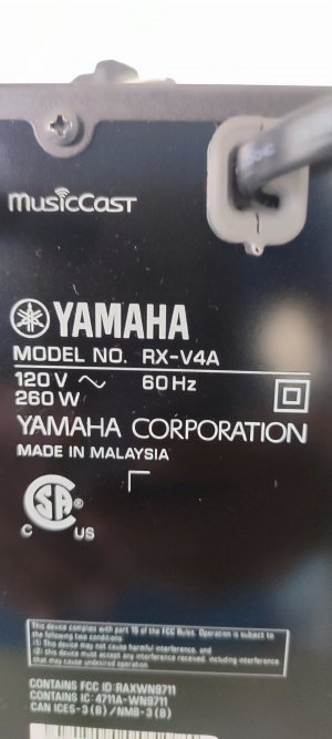

Hi All,
I just got my Yamaha RX-V4A from USA. I'm super excited to see it in action with my projector setup. However, I was unable to bring speaker with it due to luggage limitations. I need expert comments to buy speakers for this AV receiver.
I also want to know if I can use the AV receiver in India without step down transformer.

Check behind the AVR if you have a voltage selector switch 110v or 240v....if not there see whats mentioned on the AVR back panel...if 110v or 220/240v.

Thank you @efernand1,
It says 120V 😕.

In that case you will need to add a transformer to make it work with 220-240v

I am planning to buy UMI 800W Step Down Converter 220V to 110V from Amazon. I hope it will work fine. Everyone talks about pure copper winding but god knows what is inside :D

Without Step down transformer do not connect your AVR to direct power supply.
You can check maxine step down transformer, i am using it for one of the AVR purchased from US and using it for more than 10 years and works fine.
Funnily I bought a locally built product on the cheap in SP Road - the Bangalore equivalent of Nehru place in Delhi. Since these are physically heavy sturdy equipment with very few complex electronics - they should not fail you...havent bought one in the last ten years. But if you are planning to buy a Sub also from US since they are cheaper by more than 50%...they will be powered and will work on 110V as well. Hence buy a transformer with two power slots. Pune is an engineering city...so go to your local electronics/electricals hub and ask around.

I got a quality transformer from Aulten, my requirement was for USA product, so had a long chat with Aulten executive, just to confirm the product compatibility and quality, they are very good at providing resolution and transformer quality is excellent.
You can contact Aulten voltage converters at 9811597709, you can chat with them on Whatsapp also.
