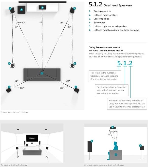

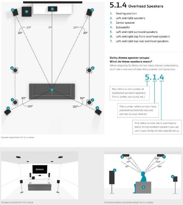

If you have the liberty, and can add speakers above your listening position (sofa), you can do 5.1.2 set-up which can do all movie formats..
If you can stretch lil more, you can do 5.1.4 in your room..
Up to you to decide on how many speakers you can accomodate above you, depending on the living room limitation.. Even if you can't position height speakers like what it is shown in the picture, you can still mount it high on front walls / side walls..
Incase you can stretch your budget, Pioneer LX 303 is a 9.2 AVR and can do 5.1.4 out of the box.. You can get a 9.2 AVR + 5.1 spakers now and add 4 height speakers later..

I did think about going for 5.1.2 system but unfortunately I don't have a false ceiling in my house. So can't get the overhead speakers installed.
False ceiling is requirement only if you are going in-ceiling speaker.. Otherwise you can mount any small speaker on ceiling with compatible / capable brackets.. But if mounting ceiling speakers is a limitation in living room, then fine..
You can also consider mounting the heights speakers high on front wall / side walls if mounting on ceiling isn't possible..
