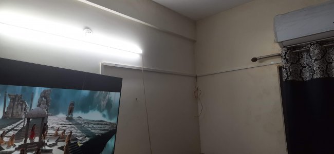

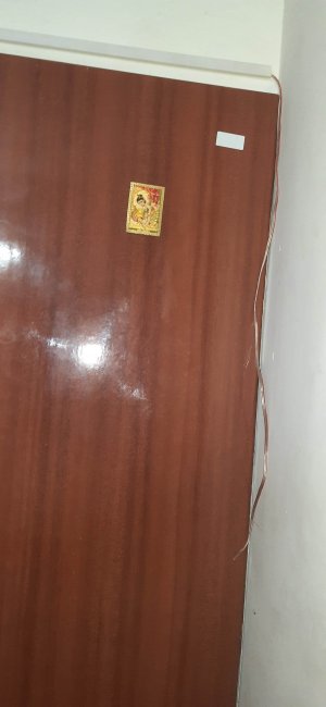

We huffed and puffed and finished it. In some places we used an existing led tubelight to balance a wire (in one stretch alone). At the amp's end where there are a sangam of many wires, we had to use a bigger patty. The speakers get about a feet of wire tailed out from the patty at certain exit points and overall a 70% level finishing perfection to what the professional hands would have done. I am having a slight hip ache. As in a couple of places I did not get ergonomic positioning and had to do it in a twisted angle. The speakers will be paired after I get the wall mounts for them.

I would not run the speaker wires on a LED tubelight.
  • EMI from the LED drivers into the audio due to proximity of the wires
  • Good to keep an inch at least from a mains powered device. Should there be a spark there it shouldn't affect the speakers.
Maybe wrap that part with aluminium foil (kitchen foil) or (if you have access to) a piece of copper / aluminium shield used on control cables and connect it to ground if possible.

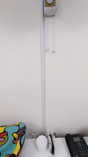

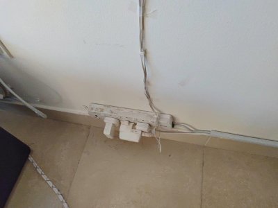

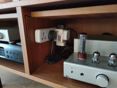

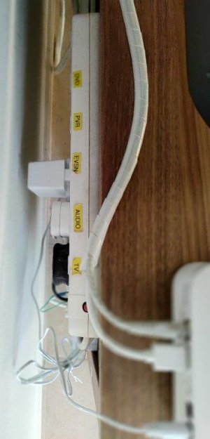

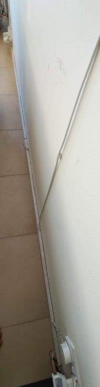

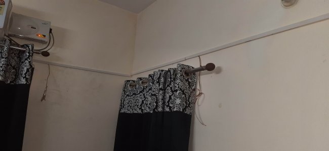

Here they are
For a fan wiring - vertical
Lighting wires -
Lighting plugs on extension unit
Main distribution on TV Unit
The Audio power socket.
The above ones have lasted 4 years now. In my previous house I used to have even more and larger size trunkings (25mm and 40mm) running everywhere as there were not many power sockets. We were in that house for 7 years. Nothing fell down.
