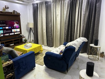

So here are some images of the set up for you:

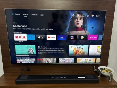

Image 1: This is how the soundbar is placed, with a Sony 65' 4K Full Aray LED TV so it should ideally go well with the Sony System

Image 2: This is the ideal placement I prefer of the Surround speakers

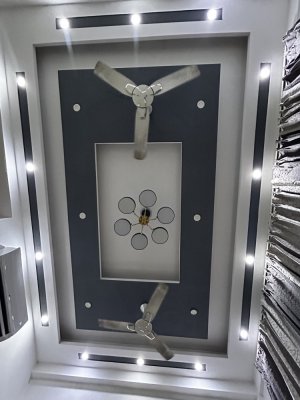

Image 3: This is how the ceiling looks like, since you mentioned it was important, it approx 9.5 Ft

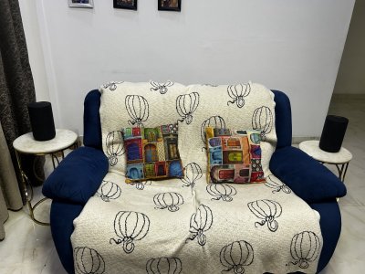

Image 4: The complete set up from side, with the surround speakers pretty close to the couch

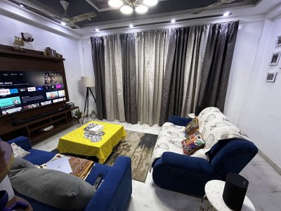

Image 5: Set up with the surround speakers a little behind the couch
I have tried multiple variations of placement of the rear speakers, and every time I do, I make sure to do the sound field optimization, which is pretty easy with the click of a button, have also adjusted manual settings in the system regarding the distance from the soundbar, placement, etc.
While doing the sound field optimization or listening to the Atmos demo built in, I can clearly hear sounds overhead but unfortunately this is the only time I can. Searched for the best scenes to test atmos, played most of them but nothing, especially this scene from "Sweet Girl" on Netflix which was recommended by someone to test overhead sounds, there is this helicopter hovering over for good 3 minutes in this scene and should be heard overhead but I could simply hear it from the side, exactly as it was in my RT-40 system.
Hope the images help you to assess and give further suggestions.

Hi again Vishal :)
Sorry for my delayed response. Was busy at work all day :D
The last pic where you placed the speakers further back seems to be the optimum position considering that they are designed as rear speakers and not surround speakers. However, You can please try tweaking it a little by trying the below 2 things :
1) Rotate the speakers such that the tweeters are angled at your ears when you are in the center of the sofa.
2) Increase the height of the speakers so that the tweeter is at ear level. I know this is difficult with the side stands, but you can try temporarily increasing the height by placing some books underneath. Tweeters are directional, and have a narrow horizontal and vertical angle of sound dispersion. so it is important to the get both the height and angle right. Imagine them being torch lights and they have to shoot exactly at your ears. Increasing the height should also increase the effect of the up firing atmos speakers due to reduced distance from the ceiling.
3) Try pulling the sound bar till it is slightly forward of the edge of the wooden cabinet. This will avoid early reflections from the top of the cabinet.
After the above adjustments, there should be an option to manually increase the volume of the rear speakers, play with the volume till you get a seamless transition from sound bar to the rear speakers. And please post back how you are finding things :)

The setup looks great. Rear surrounds slightly behind is fine. Moreover since the built in demo sounds perfect, there is nothing to doubt the system.
How is the tv connected to the soundbar? Hdmi arc? Does the sound bar and tv support eArc? If both support eArc then make sure it's enabled and active. Next the actual movie. I usually validate a system using Mad Max - Fury Road, Top Gun - Maverick, Saving Private Ryan , Life of Pi. There are various scenes in these movies that can check every aspect of a system. Starting scenes of mad Max and top gun , beach fighting scene in saving private Ryan and the storm scene from life of pi are some of my favourite.
