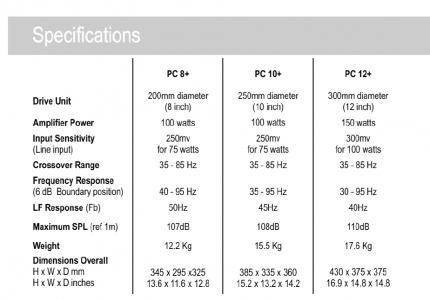

Thanks @efernand1 for the information. Yes later I could pick up a pdf from one of the old archive websites. The above is the info from there.

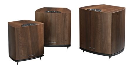

This is the sub PC 12+. I am running a jamo 200 with def tech pro cinema package currently and the idea was to augment or replace with this. They have so many models under various names. The sub I am looking at is a used one and comes at a decent price of 12k as well.
Input sensitivity is a number which I couldnt comprehend much and it is talking about line level input here. 300mv for a 100w signal and the sub is rated for 150w. How would this value differ for a sub out from AV receiver? I am running a denon.

So SPC12 and Powercube 12+ are different. PC12+ as we saw in the spec above is only 150w RMS. SPC one could be a newer model possibly.
Input sensitivity is a number which I couldn't comprehend much and it is talking about line level input here. 300mv for a 100w signal and the sub is rated for 150w. How would this value differ for a sub out from AV receiver? I am running a denon.
Input sensitivity refers to the minimum line level voltage that is needed to produce the specified output. In this example, 300mV input is needed at minimum to generate an output power of 100 watts. You may need to refer your AVR manual to see if the line level output voltage is specified in it for the sub outs. That will give you an idea of how much power you can expect from your sub. On the other hand, the 150 watt is the maximum output power of the sub amplifier regardless of the input voltage level.

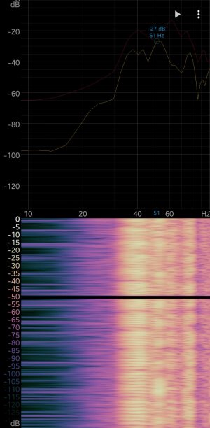

I purchased the sub from seconds market yesterday. So now I have it connected with denon 2313CI and here are some measurements, approximately at 17ft distance. I was powering this space with a Jamo 200. Jamo was clearly playing audible bass as low as 18 or 20hz. It might be due to the sealed down-firing design. Where as the wharfadale pc12+ being down-firing and ported at its resonant frequency at around 40hz gives a steep roll-off.
What I observe compared to Jamo is a more clear and more controlled bass. However, at 17ft it just touches the experience of good strong bass. Gunshots are decent, not earth-shattering. The sub is cut at its highest frequency and def tech procinema 800 with its neodymium drivers definitely play down to 100 hz range that is giving a decent overlap to the overall experience. The sub wasn't used for a year so I am keeping it running on test bass sounds to see whether any sound signature changes over the next few days.
I am able to see that at the listening position from the ref, the audio level max we get is -27db at 51 Hz. Relative to that at another 20db less the sub plays at 35hz. Not sure what is the ref 0db position it is looking at. Unable to relate to that part.
