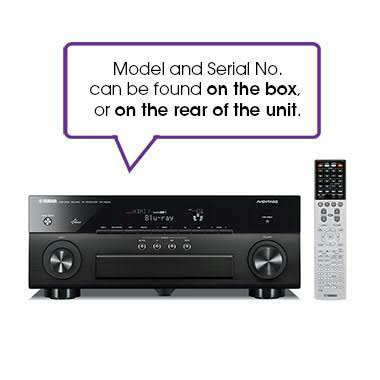

How to check the serial numbers for originality ?
Since am not available to verify in person please guide me to help my mom and dad to verify on my behalf.
Exactly what has to be done on delivery ?
http://firmware.denon.eu/serial.php
Above link shows for Denon.Similar way it is suppose to be available with AVR and Carton Box .Same number should be mentioned in the bill aswell
