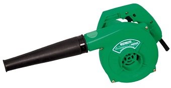

The one I have (Chinese, costs Rs 600) fits into its cardboard box 1 foot cube.

I bought mine from Lohar Chawl.
Better deals there than on Amazon.
