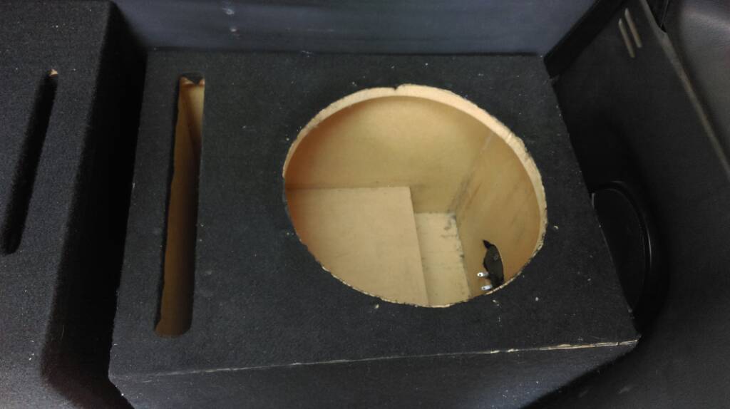

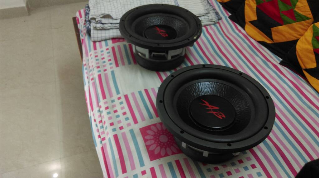

I have pair of heavy 12" autobahn car audio subwoofers. Getting monoblock car amp for dem & gonna built huge ported enclosure tuned lows around 20hz & this will be combined with my recent purchase Sony HT-M5 Explosive 1580W RMS output 5.2 channel component home theater system. Feel free to post suggestions.

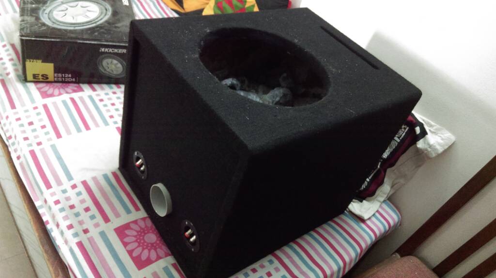

This is what I have with me. Dual 12" autobahn German made car audio subwoofers, and 2 ported enclosures. I am gonna use 2 monoblocks to power these beasts. Now my question is what would be efficient these 2 ported enclosure designed for car or one sealed enclosure having both subs? Another question is I am gonna strap both amps directly to inverter battery & that inverter will be kept on whenever I am gonna use system. I need extreme lows which should be audible in my room like I feel in car! I listen mostly to raps & hip hop by Lil Wayne, wiz Khalifa, gucci mane etc... Felt so good seeing someone using car audio stuff in home from years! Glad to know you. [emoji4]
