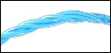

I have seen lot of diy CAT6 (corrected)cables online, was too lazy to do the weaving.. i will go and read that VH audio article
@studiomaster
soon i will open the speakers,and take pics .. i just casually tested ... but recommended twisting pattern is shown in this link Speaker Cable Faceoff 3 - The DIY Shootout — Reviews and News from Audioholics
image_preview
Correction : It is CAT6 7815A evn though CAT5 also should do well.

The braiding technique would be the same but construction differs - Chris VH separates each twisted pair to get 54 individual twisted pairs and then braids 3 twisted pairs together to get 18 braided lengths.
He takes 3 individual braided lengths and braids them together to get 6 braided lengths.
He again takes the 6 individual braided lengths and braids 3 braided lengths together to get 2 braided lengths. So each of the final 2 braided lengths would now have 27 individual conductors.

keith,yet to upload a snap of both the cables and my dac.no camera :o!!after reading the van heus article,admit was intrigued.my italian sound recording engr friend swears by them,so got 2 cables of <3 mtr run made.3 cables per ch(with jackets on),braided,terminated as straight wire,solids for +ve and stripes for -ve.4 pairs of conductors per cable,so 12 pairs of solids/stripes for a channel.works out to around 12 awg.one supposedly starts having to deal with capacitance and such for runs longer than 8ft,so caution.cheers

I think 24 conductors at 24 AWG per individual conductor would work out to an aggregate of 10.30 AWG - no?
