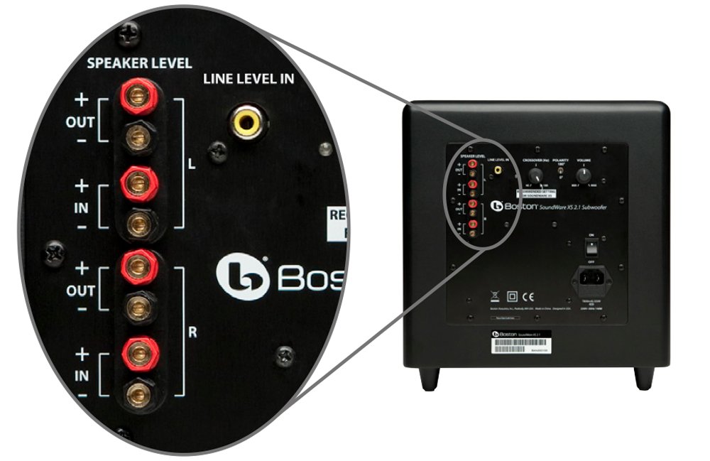

I am going to refer the back panel of your sub from this image (google search)
Image courtesy piyanas.com.
Can you please confirm whether your model looks exact the same?
First of all let me ask you - what source are you using to feed this speaker system? Full details please - like what type of cable do you use? What type of source? etc.
Looking at the sub back panel, it seems, the sub has a built in DAC. A passive pre (hopefully), 3 amplifiers. If you need to re-build this dac and want to go DIY route, it might cost you more.
If I were you, I might have constructed 3 amplifiers (with the volume control ofcourse) and the proper 2.1 preamplifier.

No that not the one I have, here is the picture of the sub that I have.
I am using a MX coaxial cable to connect from PreOut of Marantz NR1501 to LFE of the sub.

As you already have a receiver, I believe you are connecting receiver's speaker outputs to the speakers and not the subwoofer's speaker outputs. Correct me if I am wrong. In that case, you don't need the 2.1 amplifier that I've suggested earlier. Sorry that I overlooked your receiver.
We have built few DIY subs with this amp module:
Lumin - 150 Watts Power AMP Mono
I've added a 10k pot at the line input level.
The amp is paired with an over sized heat-sink, full bridge rectifier (20000uf per rail) and a 24-0-24v transformer. Its working without any problem and I am happy with its performance. However, I will upgrade the PSU and the transformer later.
