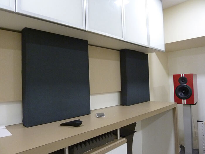

Check this for reference
Gik acoustics provides bass traps in panel shape. You can choose the designs and prints you want in case you want that option. They may not look bad on the wall. Bass panels behind the listener or behind the speakers works very well. The location depends on your room dimensions and listening position in relation to the walls.
What you see is probably the absorption panel but they apparently do this for their bass panels as well.
