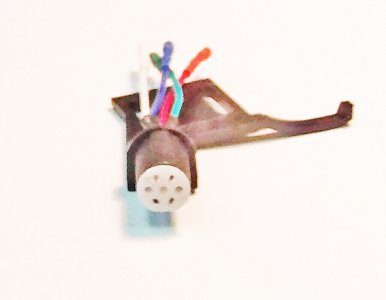

I think Philips Turntable decks of those times used plug-in headshells similar to this one:
View attachment 74786View attachment 74787

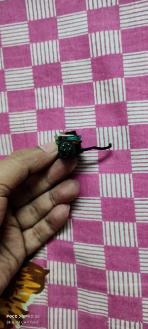

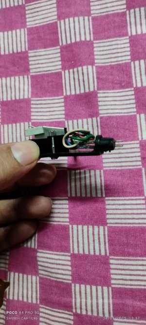

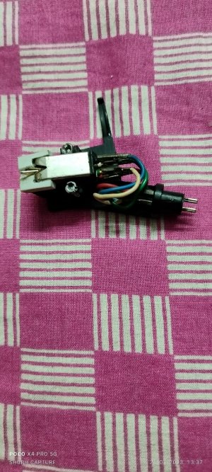

Thank you Sir for helping me. the only thing is in my Philips headshell there are 4 plugs at the back instead of the picture you shared. Sir I have posted the picture below. Please take a look and advice me accordingly.
The pins appear to be similar to a F7213 headshell, though the shape is different. Please give me a day to check the headshell and give you a feedback. BTW, which stylus are u using on the Classic 700? Thanks.
I compared a Philips F 7213 headshell with above. The size and angle appear similar, though cutting on body is lightly different. The pin is approx 5 mm and the distance from the collar to end of pin approx 11.5 mm, given scale error. My guess is this may fit your tt and could widen your search for these types of rare headshell. Also, be cautioned that this has a fixed 1/2 " mount i.e. the cartridge is not adjustable forward or backward.
Primarily designed for Philips Cartridges, certain cartridges like the common AT 3600/91 etc may not fit due to top black plastic interfering. I had to carefully file an edge! Hope that helps. Do let us know ur progress.
Hello Sir, kindly take your time and yes I am using Classic 700 Black. Sir, I will upgrade the cartridge to Classic 700 Orange in the future.
