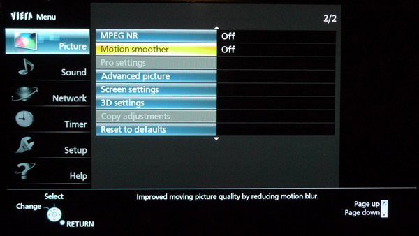

This is the reason I bough a TV specifically with 200 HZ native refresh rate panel and interpolated rate of 800 Hz with backlight scanning.
Try modifying the motion smoothening setting in the following menu and provide feedback.

For some reason i am unable to view motion smoother option in picture menu. What i have is...Noise REDUCTION, MPEG REMASTER, INTELLIGENT FRAME CREATION. For some reason ADVANCE option is grayed out. Trying to explore how to enable it and see if can see that option.

What is the picture mode you are using ? Please keep the picture mode to General or say cinema and try the advanced options. In Certain picture modes, the advanced options are greyed out. Like in Game mode Etc.
Also, the settings you do for one source, stays to that particular source only. At least in my TV. ie if you want different custom settings for STB and USB source, it can be tuned once and the TV remembers it.
Ensure you have some General picture mode and try again.
i think, "INTELLIGENT FRAME CREATION" might do what motion smoother can
@gurujee...Yepp ... i have disabled it and tried watching the same clip...i believe i saw some level of improvement after turning that off. Still some judder does pops up..

I am inclined to say YES. There are other factors to be considered, the downloaded movie file format (should not be an issue), the frame rate and other technical parameters...after tweaking the settings for the downloaded files or say playing through USB picture settings, I did see a difference with almost no jutter or choppy frames. Watched downloaded Avatar 3D...it played well. The colors on this model or say series are more natural. Thats my view and opinion. Just one note on techs visiting from service center for demo....they are not good. Nothing more to add.
