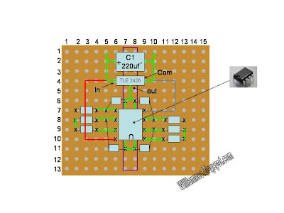

cmoy is very simple to build..see this blog that gives full details DIY Simple Headphone Amp Tutorial: Cmoy Amplifier

still simpler way is to use cmoy pcb ...http://www.jdslabs.com/cMoyBB202PCBG.php
