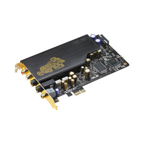

If I'm coming out of my PC digitally for that long run... is there any point in investing in a good sound card. What does a good sound card (eg Xonar Essence STX or other) do to improve upon an already digital signal leaving the PC?
Hmm, the stx does not appear to have an optical out, just a digital coaxial out. If you used a digital coaxial it would most likely suffer the same problem as analog rca, even if it's heavily shielded as 70' is just too long. If your integrated soundcard has an optical out you can use that to let the avr use it's own dac, but the question is will the signal reach across 70'. A good soundcard will do more than just improve an already leaving soundcard, it will give you lots of features to modify the sound through the OS and also a cleaner transport.
It does have an optical out. If you put your hand in front of the digital RCA, you will notice the laser. You need a S/PDIF optical adapter (comes with the card).
ASUS - Multimedia- ASUS Xonar Essence STX
I have the ST, but have never the optical out.
Wow you're right, that's pretty cool.
@OP then yes you can consider the Xonar STX.
