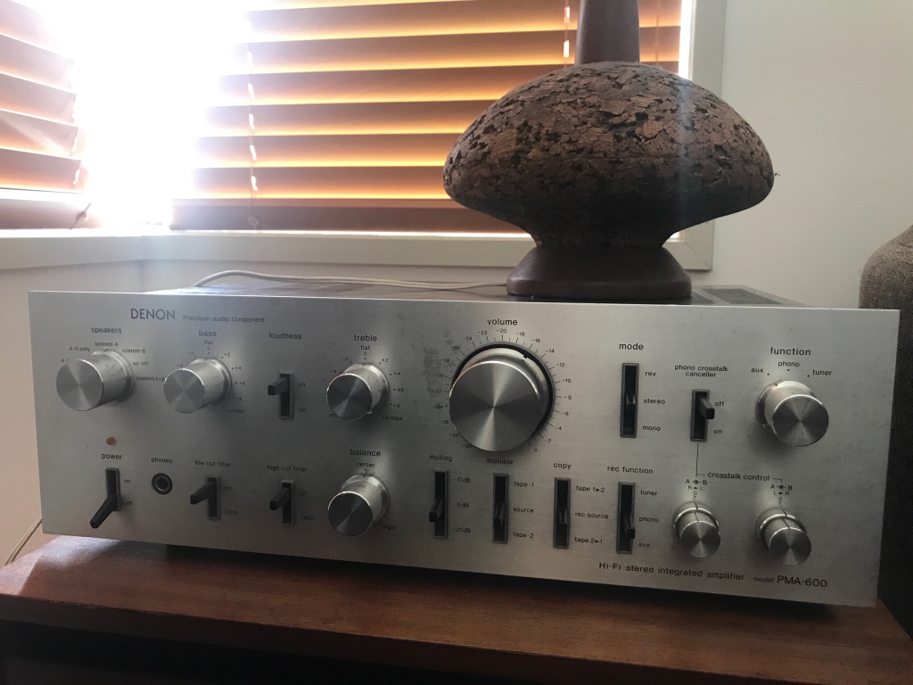

Meh, Im afraid to say that Denons glory days were the 1970s and since then (with a few exceptions in the 80s and 90s) they produce crap. I have a 1978 Denon PMA 600 dual mono amplifier which is the real deal - its as sweet sounding as a tube amp. Any other vintage aficionados out there who know what real gear is? :
