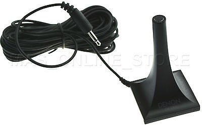

I had started a new post earlier.... Posting it here as well to see if any denon owner in Bengaluru would be willing to kindly lend their audyssey calibration mic for a while . This is for Denon 1910 but I beleive a mic from any model around that time will work.. Pls do let me know thank yous-l400.jpg

I had started a new post earlier.... Posting it here as well to see if any denon owner in Bengaluru would be willing to kindly lend their audyssey calibration mic for a while . This is for Denon 1910 but I beleive a mic from any model around that time will work.. Pls do let me know thank youView attachment 72797
Thread 'Denon 1910 - Calibration Mic needed in BLR'
Try reaching out to local dealers in Bangalore. They might have a spare mic lying with them. You'll find lots of dealers on OLX.
