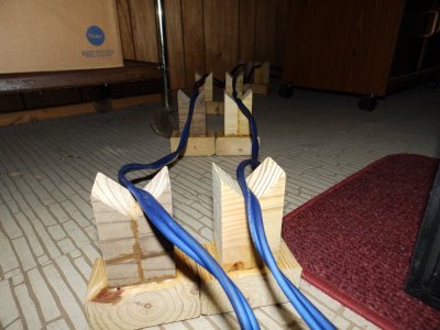

DIY speaker cable risers

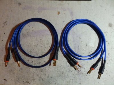

Fulton length speaker cables (57 1/8" x 3) with Kord Kable 10AWG by KnuKonceptz.
The wire has 462 stands of OFC in a flexible blue PVC jacket.
This is the main speaker cable from Manifesto SE amp to DIY Altec crossover, replacing vintage Monster Cable 12AWG stranded copper wire.

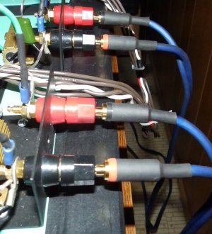

Fulton length speaker cable terminations: Legrand banana plugs with heat shrink to keep as cable as airtight as possible.
Cables are connected in reverse polarity at amplifier due to use of 2nd order crossovers.
The most difficult part of installing any new cables is the patience required for proper break in.
Knukonceptz OFC speaker wires sound pretty good from the onset of subjective evaluation.
DIY Fulton length (57 1/8'") cables made with Knukonceptz Kord Cable 12AWG and terminated with Legrand banana plugs.
The plugs are sealed with a 2" section of Gardner Bender 3/8"/9.5mm heat shrink to maintain an air-tight condition.
The new cables will connect from DIY Altec crossover to DIY Altec 414-8B cabinet replacing vintage Monster Cable 12AWG stranded copper.
Internal cabinet wires will be inspected and refreshed if needed with Fulton length cables.
