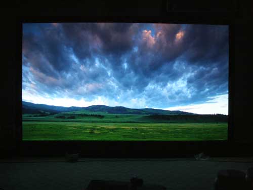

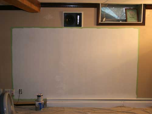

Well others have said soo much,but here's my 2cents on the thing :p !!
A dedicated painted wall can give any commercial screen a run for its money if done properly :ohyeah:!! There are various ways one can achieve this !
Here's a product specifically made for the purpose. Here's the link of that ;) !! There's loads of info on the site regarding the topic,so make best use of it !!
Screen Paint
Here's some sample images of it !!
Before the paint.
After the Paint.
Screen Shot of the image projected.
There's a friend of mine who has done this in his house and we have compared this to a best available Silver Matt High Gain Screen and The wall took the cake walk without breaking a sweat :ohyeah:!!
