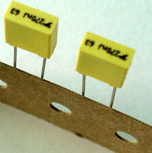

I'm not sure if those yellow (Thomson?) box-type film caps are polyester, but if so, you can consider upgrading them with Rifa PFR or Wima MKP/FKP polypropylene film caps, subject to availability and space constraints. Resistor upgrades are also possible, for instance to Vishay/Dale or KOA non-magnetic MFRs.

linux guru , i will do upgrade .. for those boxies ..rifa i get here n some wimas too, almost all box caps are 100kpf.will try after some time tedious to remove as the pcb is PTH,thanks my diy hot air gun will help.
some shocking info on the caps these are same caps i have Subminiature Metalized Polyester Film Capacitors (Capacitor)
claiming some reference grade ..? if the guy sent cerafines may be the poly caps may be of good quality ,letz see ears will tell

Yup, it looks TPC-brand polyesters. Polyesters are better than electrolytics and some ceramics, but C0G/NP0 grade ceramics can easily beat the quoted dissipation factor of ~1% on these polyesters. Polyphenylenes (Wima MKI2 or Rifa SMR) are better at around 0.1% or lower, and Polypropylenes (Wima FKP/MKP, Rifa PFR/PMR, etc.) are even better at <0.01%. The main issue is getting them to fit in the 5mm pitch and space provided.
i saw Argen Helder topping kit also uses TPC polysters , sound convincing [noob comment!]..compared with MKS wimas these need1mm more space .But still surgery is possible ...in future.
