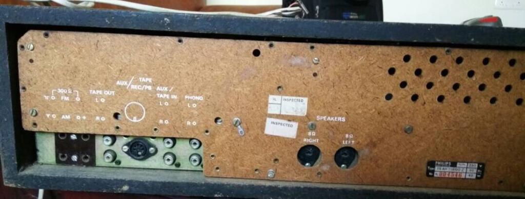

I got the Tuner Amp Philips AH718, which is working I guess, but unable to figure out how to connect my Boston Acoustics BA26. The speakers out- post is kinda vintage which I've not encountered earlier. Any help from FMs would be great.

Those a Philips speaker sockets. You'll have to get yourself a pair of these to wire your current speakers to this amp.
These were quite common when Philips dominated the Indian market with Hi-Fi, in the 1970s and early 1980s. If you go to older electronics component shops and ask for Philips Speaker plugs, they may have stock.
