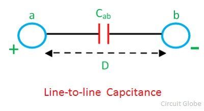

D is the distance between the two conductors
If conductors come close capacitance will increase, keep them far low capacitance

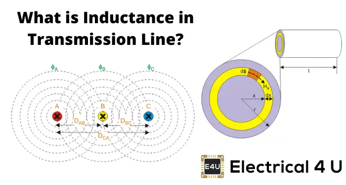

Now no one speaks about the poor inductance 😭 😭
if wires are kept far inductance will increase, keep them close aha low inductance
inductance between wires would be a affect HF, inductance in series would attenuate LF????????
endless possibilities
So come to a sensible compromise :)

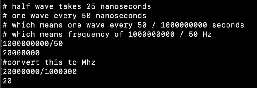

If I understand correctly 25 nanoseconds rise time, which is basically half wave. So full wave is 50 nanoseconds. Basically it means a 20 Mhz signal. That's my understanding and I may be wrong because my specialization is piezoelectricity and ceramics in materials science. So anyone with strong fundamentals correct me because at this moment i have 2 many pegs many of questionable quality. The question I have is if the digital signal for SPDIF is in 20 Mhz range?
calculations done using bc in a terminal
EDIT:
Sorry. 50 nanoseconds will be to rise from 0 to full wave and back to zero. To go to negative and back it will be another 50 nanoseconds. So the frequency will be 10 Mhz

Rise time is the time taken for a rising waveform to go from 10% to 90% of its peak amplitude.
Ok. Learnt something today. But even then, it means that the transmission of the SPDIF is in Mhz region. Is this true and can someone confirm this?
Yes, it is in MHz region. See the pdf paper in the second search result. The clock speed differs for different sampling rates.
2 times x X kHz signal sampling rate x 64 = Y MHz, is the clock speed. For 192 kHz the clock speed is about 24 MHz.
