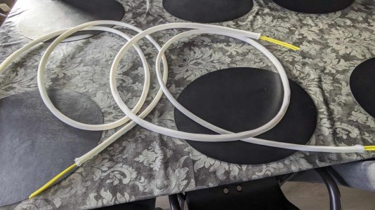

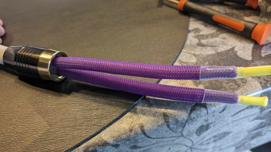

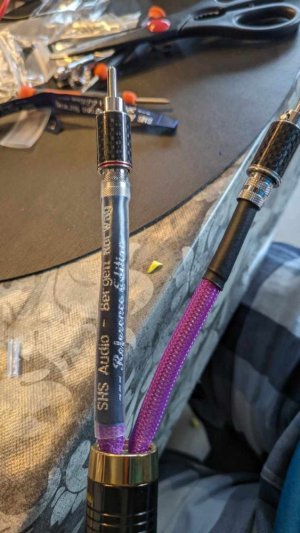

I've been working with this wire for 10 years now. I have used mostly the 8 AWG variant and sold these cables to high enders all over Norway. Simply the best cables I have heard to date. I have considered mixing gauges. i have made a 10 awg + a high frequency tinned twisted pair at 20 gauge wire (great combo) here's a future pictures of my latest protoype :)
