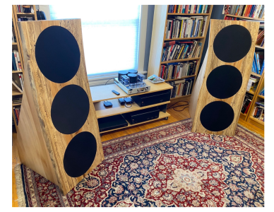

Another good option is to clone these, (if you have space that is)
https://evo2.org/wp-content/uploads/2023/07/Bitches_Brew_Open_Baffle_Live_Edge_Speakers.pdf
Since you are using DSP amplifiers, you can always build custom crossovers fitting the drivers easily, no more iterative passive crossovers.
This one is easy to build too, less things to go wrong, with DSP one can always change things. You will have to measure and build crossovers in DSP.

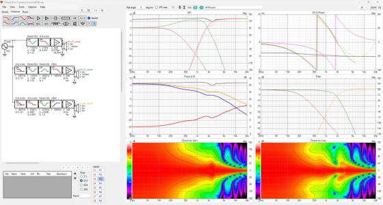

If one makes a regular TM combo (even with high end drivers) the on-axis and off-axis will never match and nothing can be done.
If one makes a constant directivity design and uses a waveguide for tweeter and woofer/midbass sitting below then the on-axis and off-axis will match horizontally but not vertically. Vertically, there will be lobes. However, horizontal is more important than vertical as our ears are placed horizontally to sense horizontal better. There will be difference in sound when sitting or standing.
If one makes a coax design then it behaves like a true point source, the on-axis and off-axis will match both horizontally as well as vertically. This creates similar sound while sitting or standing and is more enjoyable
A MTM is as close to a point source that one can get with conventional speakers. That's what I have and honestly their is very little difference if sitting with tweeter at ear level or if one is standing. Horizontal dispersion is also very good.
I completely agree with your statement that speaker building is a lot of fun. I had a blast making mine though I drove my wife crazy.
MTM has lobing issue around crossover frequency as seen in right bottom graph, thats why I suggested coax and OP already was inclined to use
coax
