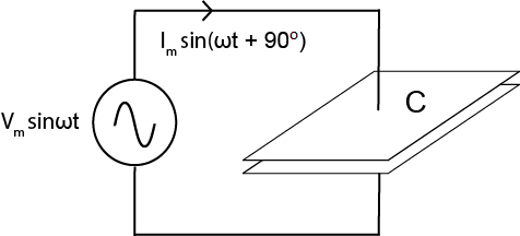

yes. Impedance due to capacitance and inductance are frequency dependent.
Capacitance causes impedance to decrease as frequency increases. Any two conductors close to each other causes capacitance. This capactiance depends on the distance between the conductors, the surface area of the conductors and the medium between them (called dielectric). Any cable has capacitance. cable capacitance shorts higher frequency more than lower frequencies. Hence cables with high capacitance will lose HF component. Thick cables (thicker inner conductor) will have high capactance. Longer cables will have higher capacitance, Increasing the shielding around cables increases capacitance. cables with thinner insulation will have higher capacitance. That's why we have twisted pairs. The twisted pairs inside CAT cables have the copper wires coated with a material with a dielectric that gives very very bad capacitance. Hence it is very good for high frequencies. The copper wires inside twisted pairs are very thin to have low surface area. Thinner wires do increase resitance but resistance is not frequency dependent and is a lesser evil compared to capacitance.
The impedance due to capacitance is inversely proportional to frequency and capacitance. It decreases for higher frequency and higher capacitance.

Inductance causes impedance to increase as frequency increases. It is directly proportional to the frequency and the inductance. Any twist and turns of cable will cause inductance. But in general inductance can be kept quite low.

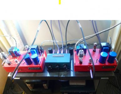

A visual from 2016 :
Not my set up, but notice how the black and white speaker wires, coming off the amp on the right, have polarities separated ? Notice how the two channels from the attenuator are totally distanced from each other? BTW, that speaker lead wire is m22759/11. But in 2016, we were only using 12+12 AWG, and had not gotten around to do the testing to confirm the best lengths. That was optimized in early 2020.
