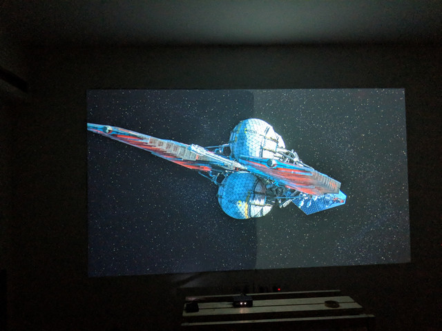

I recently purchased a generic Retro reflective screen from Ali express for about 30 usd. I see lotta queries on screens on the forum, so yes this is another option to consider of you don't have a dedicated theater room with all black walls. The only limitation with a retro reflective screen is the viewing angle. Viewing angle will be restricted to 20 degrees. The screen comes folded I have not removed the fold marks yet for now I've just temporarily stuck it to the wall so that I can align my projector correctly.

That looks nice with all that ambient light spilling in. What projector have you got?

Looks good..Please share link to product..
Would you mind posting an other pic with image on half of the new screen Vs DIY grey paint.. Just for a comparison, on how much is the improvement with light in the room..
The improvement is pretty dramatic as the screen's gain is very high. I'll try to take a pic tonight. I have the projector's led set at 1 for day light viewing

This is the diff between the black widow paint and this screen. Black widow is a milder retro reflective paint so it has better viewing angles

Technically this is the same stuff used in hi visibility vests. But getting such a large section of the material was hard, luckily someone in china was smart enough to sell it as a screen :D
How was it fixed? wooden frame or tapped to wall? Looks really good..
It's just taped for the moment. I'll build a frame in a while I'm feeling a bit too lazy this week
And on a general note, the insane gain on this screen makes 3D content look incredible it's like watching it on my Panasonic plasma.
