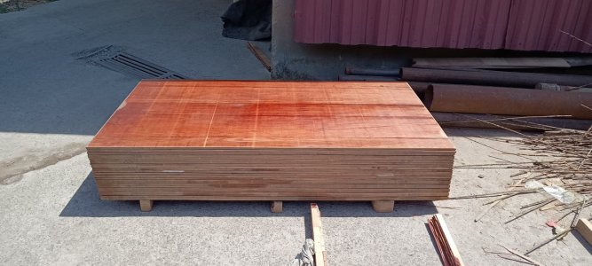

The material is not a ordinary plywood nor a particle board. Even the best quality plywood density does not cross 0.6gm/cm³. Particle board is much less.

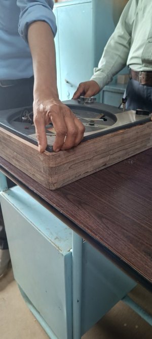

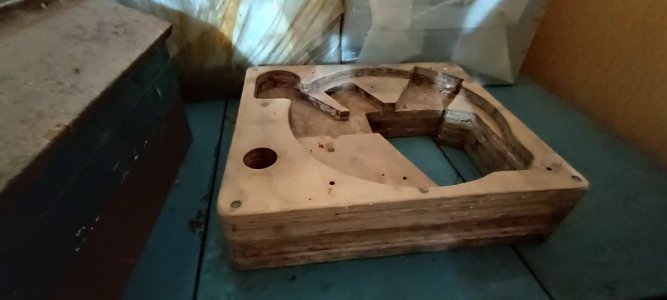

The material has one or two brand names , one of them is Permali. If one searches for "Permali Plinth" the search results shall come up with several discussions across various audio forums. Am attaching photos of 2Mx1M sheets and Lenco plinth made of this material.
Regards,IMG_20230608_101935406.jpgIMG_20230806_160842274.jpgIMG_20230802_154632131_HDR.jpg

Right. The only difference I see is that Permali is impregnated with resin instead of just glue between the layers in plywood. This works well to make it waterproof. The rest of the process appears to be the same, including the glue.
It is densified engineered wood.
