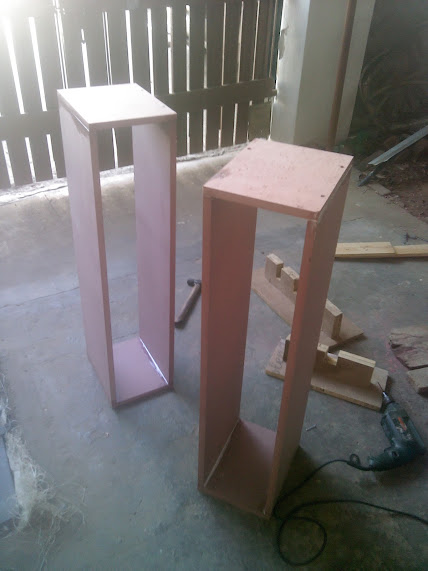

Used MDF 17mm boards as that was available. The next available was 25mm and that was too expensive for me. So decided to go with 17mm board
For me the search for a carpenter did not succeed. Asked few guys, but none of them were willing to take up the work when I told them it is a speaker cabinet. So the first thing I did is procuring few wood working tools like chisels, drill bits etc.

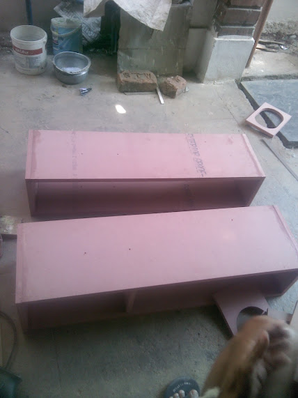

Found one workshop doing CNC cutting and got the MDF cut into sizes. Altogether 28 pieces for the 2 boxes including braces. Cost of MDF around Rs 3000+ and cutting cost around Rs 2500.

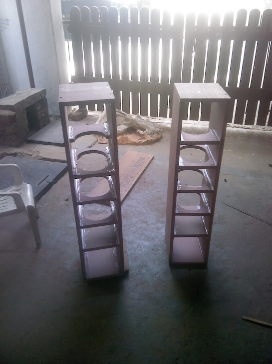

Box making. The boards were joined using screws and Fevicol SH.
Making the box part took couple of weeks as I could work only on weekends.
Once I started to paste the No-Rez, realised that I dont have sufficient quantity. I could source the Tar sheet instead from a local hardware shop and pasted those in the remaining areas.
Rounding off the woofer hole at 45 degree was another challenge. The chisel I bought from the hardware shop was not that good. But with lot of effort, I could manage it.
