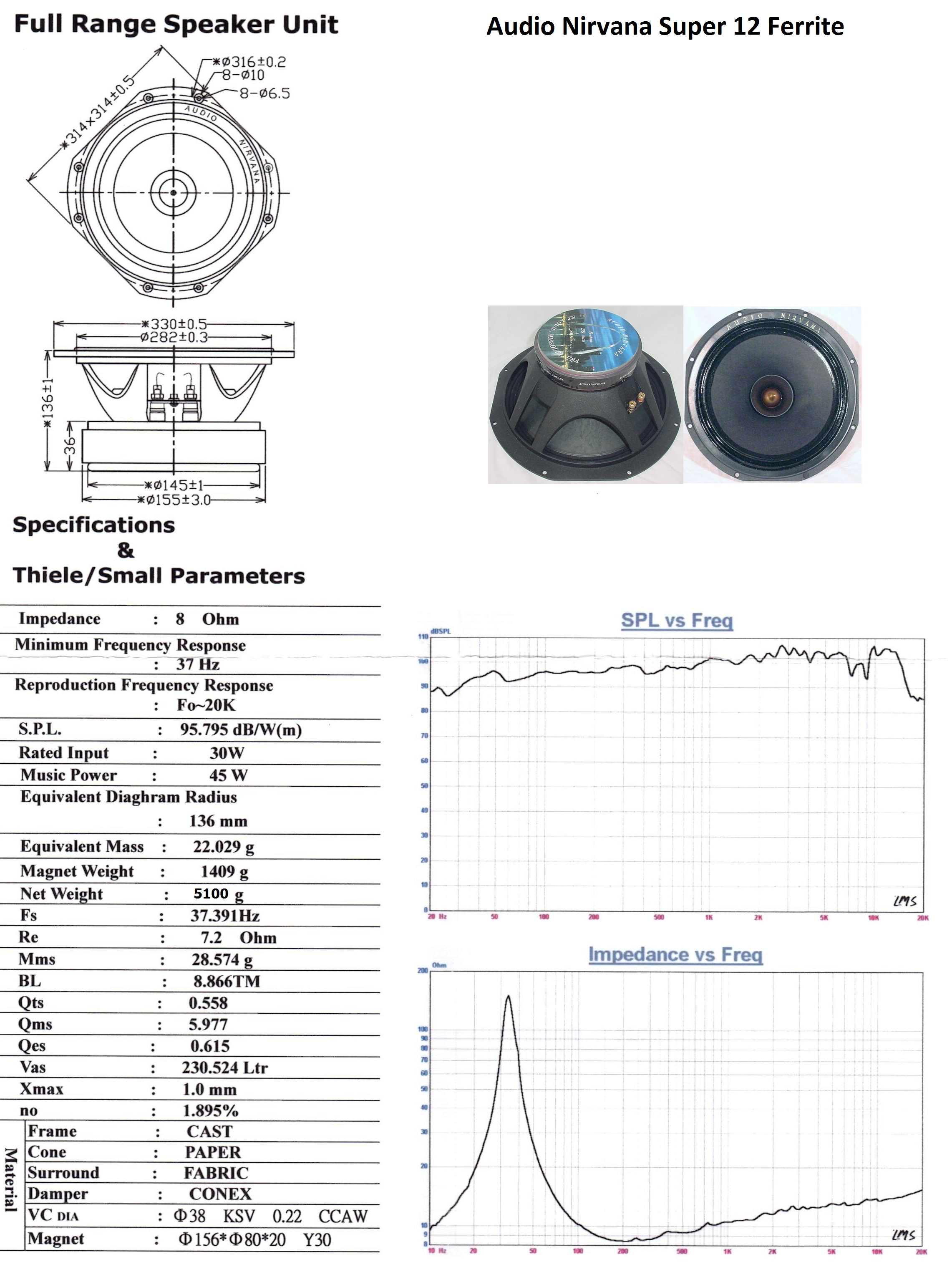

Those who have seen my other threads would know that I was looking for bookshelves that could be driven by my 1wpc Linear Tube Audio mz2. Sensitivity needed to be > 97db. The guys at LTA recommended either Zu Audio or Omega. Prices were high and reviews were mixed. Encouraged mainly by fm @yogibear I decided to give high sensitivity single driver full rangers a shot.
I used 12" AN Ferro Super drivers and 1½" steam beech panels. The design was largely based on AN recommendations + trusted sources.
Dimensions are 39"H x 25"W. The two side panels are 15" at the bottom tapering to 9" at the top. The front panels are single cuts of wood with no joints. All panels are 1½" beech.
