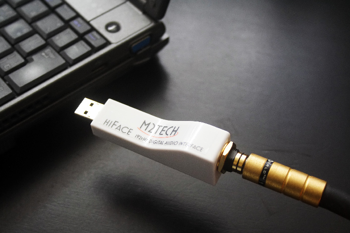

Since you already have good DACs to boot, why not consider something like the M2Tech hiFace? After few futile attempts to procure a used Bel Canto USB Link 24/96 USB-S/PDIF converter, I'm inclined towards getting the hiFace.

The M2Tech is a USB->SPDIF converter with its own drivers that work in async mode. If you already have good dacs, this is the best way of testing things out. The biggest difference between this and the rest of the converters is that it can natively handle 44.1 and 48kHz without sample rate conversion as it has crystals for both. Its one of the very few devices that can do 192kHz/24bit over USB. I have one of these sitting with me and I find it to be better than a dozen other USB devices that I've used so far. Overall I still prefer the EMU PCI card though. YMMV.
The hagtech and behringer are rubbish as they are based on PCM2702 implementations for USB->SPDIF conversion. They are synchronous and hence depend on the host cpu to provide the correct clock. This never works properly in practice.

Yup - use your favorite digital cable and you are good to go. It needs drivers that you must download from the m2tech site. Otherwise it won't work.
Its available in two versions - normal RCA and BNC. The latter is around 15 euro more.
