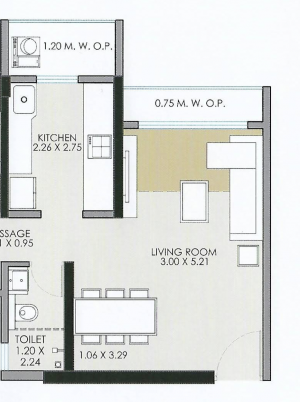

I have a l-shape living, and the layout is attached. There is no other possibility of placement of the sofa.
I think, I might have to go for bipole for surrounds (Wharfdale WH-DFS).
Is 5.1.4 with front and rear heights (don't intend to cut for in-ceiling) possible in this layout?
Is 5.1.2 with just the front heights worth it?

Yes, it is doable, but I do see three issues, all of which can be addressed:
1. The reflections of the speaker closer to the balcony will be higher than the other front speaker. Solvable with some treatment and correction.
2. Surround positioning will be tricky - you can attempt putting up one surround on the french window wall, and the other on a stand at same height.
3. With the room so open, pressurising it will be difficult for even the most capable sub. The problem can be mitigated a bit by placing the sub somewhere closer to sofa.
As for height speakers, four always better if you can get close to the recommended angles. Else, happily go with two front heights.
