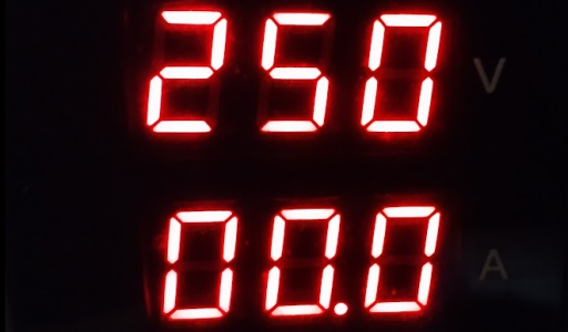

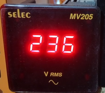

I have also put voltmeters at strategic locations
Input voltage right now on my voltmeter at inlet
Output voltage right now on my voltmeter at outlet
