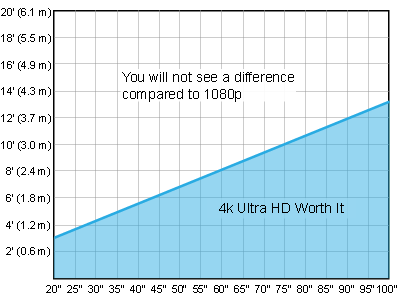

I have read that being upscaled to 4k makes SD content look worse than upscaling to 1080p which is what most of the content we get. Not talking about LeEco but all 4k tvs. Unless you have every content 720p/1080p where 4k upscaling does work fine. Also to notice the difference between 1080p and 4k you have to be at the correct distance of no more than 10ft. In my case this makes 4k tvs useless as my sitting is 15ft in the room, more than 20ft in living room.

This guide helped.
4k vs 1080p and upscaling: Is UHD worth the upgrade?
So can good scaling make a 1080p image look good on a 4K TV? Compared to that same content badly upconverted, yes. In CNET's reviews of the better 4K TVs, we've found that 1080p Blu-ray upconverted to the 4K screens looks great, although not appreciably better than 1080p on a 1080p TV.
It's also worth noting just because content is in 4K resolution, that does not necessarily mean it's "good." I've seen some convincing demos where pristine upconverted 1080p content was shown on a 4K TV, side-by-side with the true 4K version of the same content on a second identical 4K TV. It was hard to tell the difference, even up close.
But that wasn't a real-world demo. In the real world, most content isn't pristine. In the real world, streaming 4K content from Netflix or Amazon can look worse than 1080p Blu-ray. CNET's hands-on comparisons of 4K streaming (and 4K from a Samsung UHD content pack and from Sony's 4K video player ) versus Blu-ray showed very little difference for the most part, and at times the Blu-ray looked better.
That said, the best 1080p content is never going to look as good the best 4K content. It's just not possible.
Lower-than high-def sources
Upconversion is more difficult with lower resolution sources. Standard-definition TV, DVD and even 720p HDTV programs aren't going to look any better on a 4K TV. You can't get water from a stone.
And it's worth remembering that the more you sharpen an image, the more you accentuate the flaws present in lower-grade content, such as noise or macroblocking.
So will a 4K TV displaying lower resolution sources look worse than on a 1080p TV?
That depends on the TV. Will this older, lower-resolution content still be watchable on a 4K TV? Generally, yes. Some videophiles may balk, but for the most part the image will be soft, but not bad. But again, it can depend on the TV. Which brings us to...
Almost every TV
Just because a TV is 4K doesn't mean it has a good scaler built-in. On cheaper 4K TVs, for instance, you probably save money because of a sub-par scaler. So in these cases, 1080p content probably won't look any better (and possibly worse).
Sadly, as far as scaling performance is concerned, you usually get what you pay for.
Bottom line
Like any marketing, take the claims from TV manufacturers with a grain of salt. Good upconversion can improve the apparent detail in an image; I've seen side-by-side demos that make 1080p look nearly as sharp as 4K. Admittedly these were put on by a company which makes scalers, but the potential is there, just as it was in going from standard to high definition.
To get the most out of your 4K TV, you need good 4K content. There isn't a lot now, but there will be more soon. In the meantime, a TV with a good scaler can make 1080p look slightly more detailed, than it would on a similarly-performing 1080p TV. Presuming, of course, you're sitting close enough.
https://www.cnet.com/news/can-4k-tvs-make-1080p-look-better/
