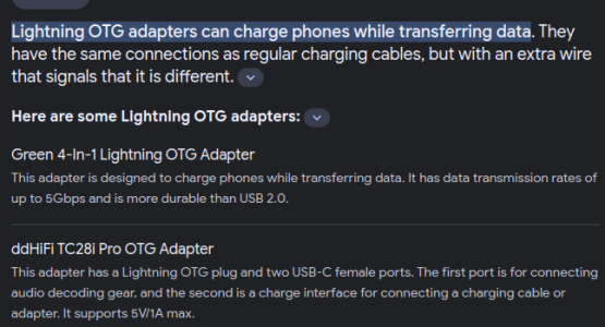

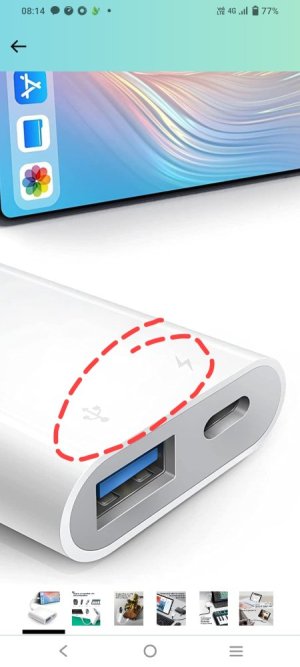

This adapter has one usb power port where you can connect the charger.
Basically dac will not push power for streaming devices to charge.
This adapter can take the dac connection and external power charger connection, bundle it in a single lightning port.
