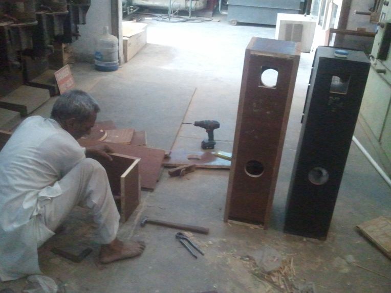

Old speakers from OLX Rs. 1,000
Carpenter Rs. 2,500 (incl. machine cutting)
Paint & Brush Rs. 400

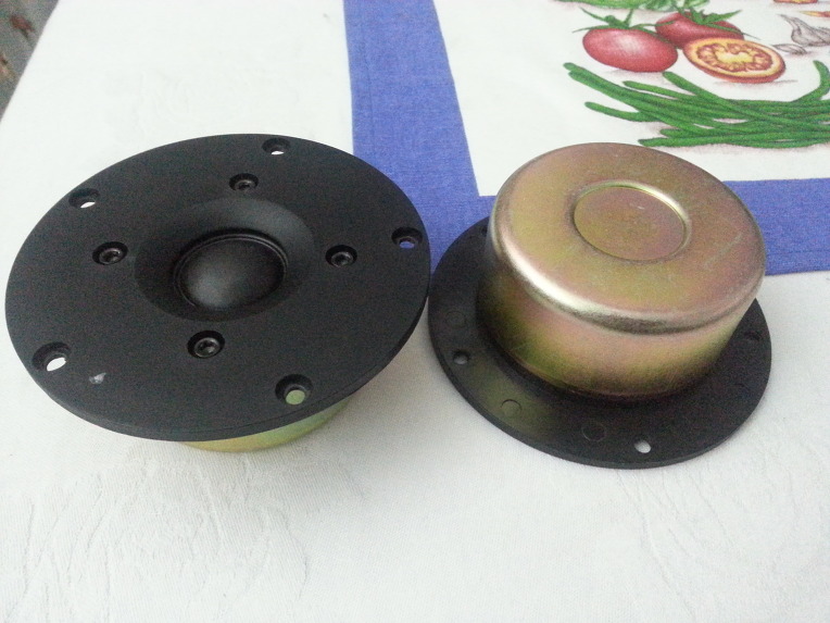

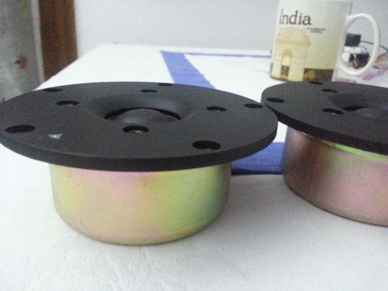

Ply wood from old cabinet, twitters from my bookshelf speakers.

Rather than cotton filling, you can try to purchase suitable size of felt from diyaudiocart dot com and try on inner walls. Also using glass wool or polyfill sould be thought.
Was there some passive radiator or port somewhere?

It has port in back side of the speaker.
The size of the enclosure is same as the original.

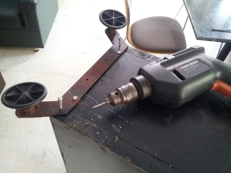

I am going to give feet to my speaker.
- Speaker Outrigger -
the seasons for outrigger are
1. speaker spikes are too expensive
2. my wife does not allow to make any harm to floor
3. my precious speakers is not to be fallen down
4. it looks quite good to showoff

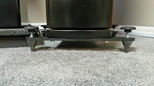

Bench Marking (all images are from google)
2548153E5629C5C704F4E9
273C483E5629C5C30FA88F
235554405629C648159587

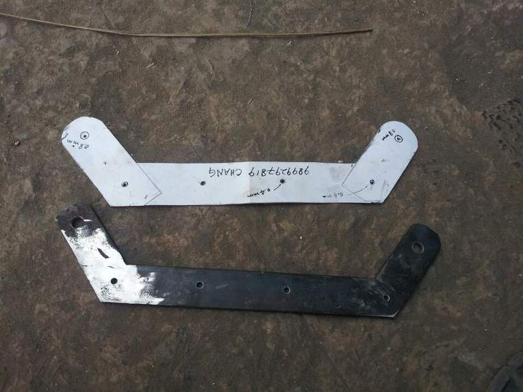

My Design
2701EE3B5629BF1601836E

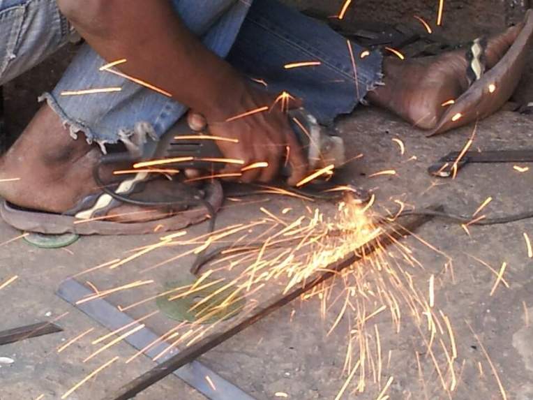

After making the design, I went welding shop.
They did what I wanted
welding + grinding and making hole
Total 4 outriggers (two for one speaker)

After putting the outriggers, I feel that base part became little better making more balance with twitter.

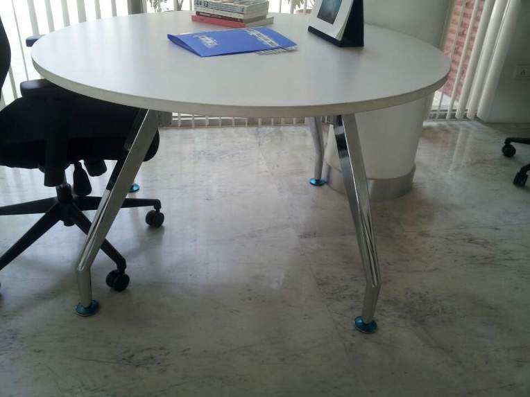

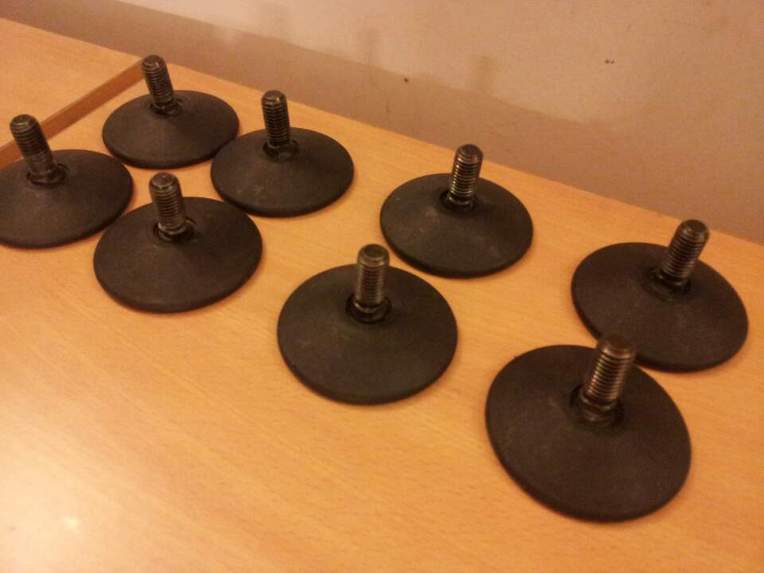

The part I could do were painting and finding shoes instead of spikes.
I got them from round table - leg shoes.
In my office, I got an idea to make speaker shoes looking at the table legs.
21619A3B5629BF121F98C9
These are shoes that I am going to put to my speakers. I found them from other unused table
The shoes part and bolt part are flexible that I can adjust the height.
22724C3B5629BF0E0E2F59

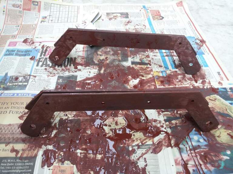

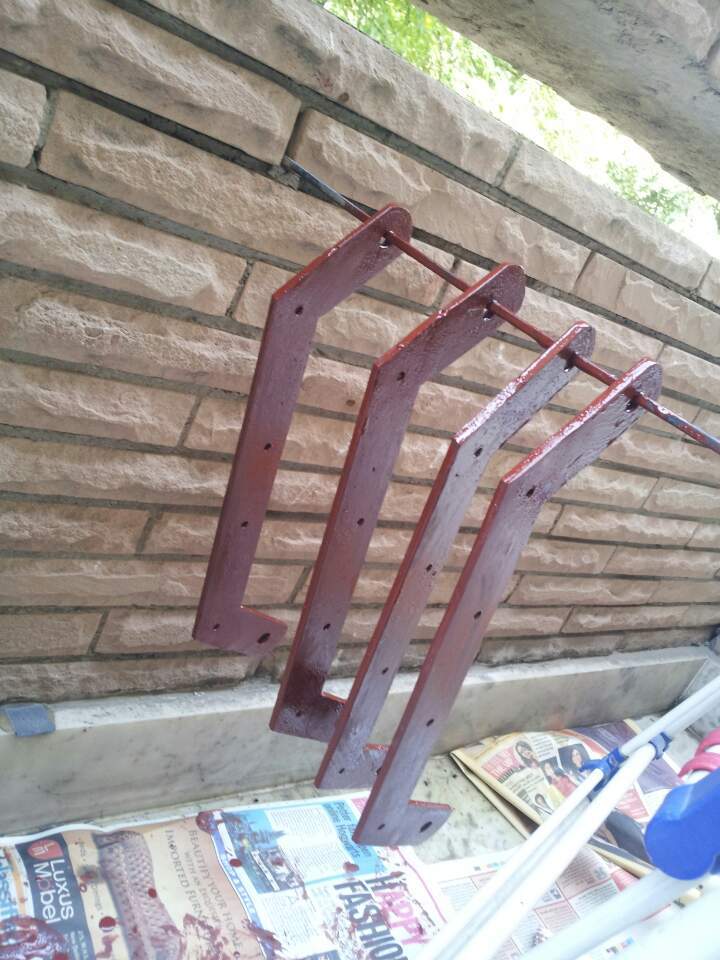

Painting Primer (red oxide?)
266DB84E5629C28B103269
2761754E5629C2851C64CD
