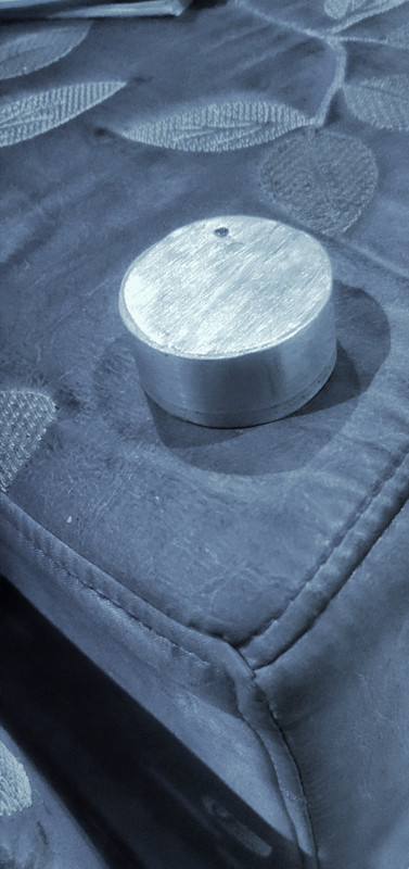

This knob was made with sheet aluminum and just a metal scissor
1.cardboard or mdf base made
2.metal is attached in 2 shapes
one round cut
second long for periphery
used superglue
and sanding to finish
if there is interest i will share more pics of the diy

It will be better if you share pics while its being made
I understand u glued two semi-circulqr alluminium plates bend two make a full round but what's the gauge/thickness of alluminium used ?? How you made the female part to accommodate the shaft.. Plz share the central part or inner pic
Here is back side pic
There are many ways tomake the back side shaft hole
i used stacked 2mm mdf and dremel work to create a 'D' hole
due to several drops of superglue the mdf gets hard like hard palstic
Alternately keep a fat block of MSeal.
wrap the pot shaft in paper
push it in to make the D hole.
keep over night..it becomes rock solid
***important always make it at centre
so rotation will be perfect
you can even beautify the back side .
* do sanding
*put black solid hot glue (special stick is available black one)
*heat up with heat gun or tawa..in low flame
whole back will be like plastic black
Two Knobs i made one has to get the black dot.
cost compare:
tanotis dot com sales bigknobs flr 485 plus shipping 140say
2knobs will be 625₹ x 2 =1250/-
Diy material cost:25/-
plus few hours of spare time
