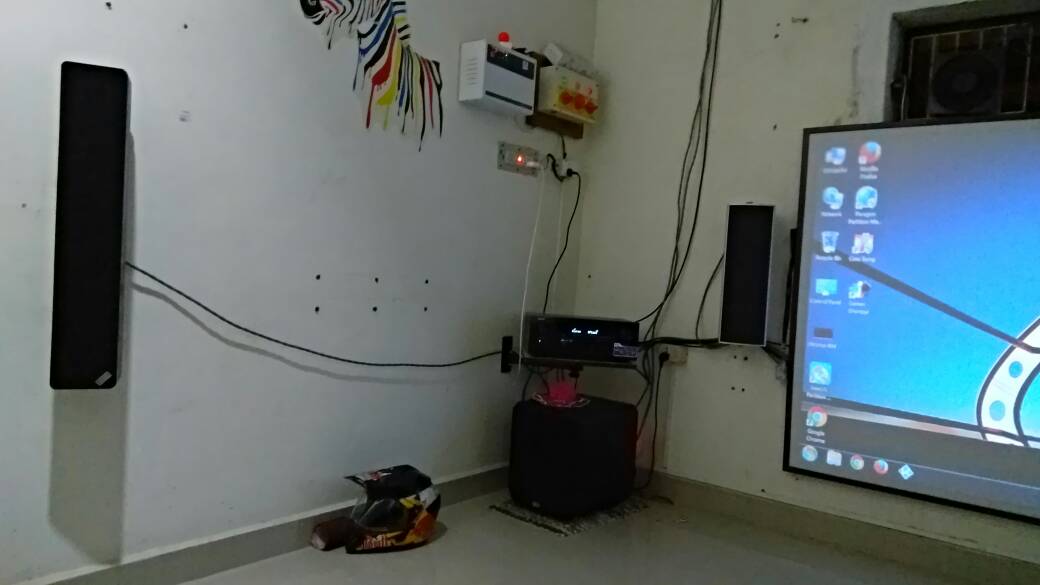

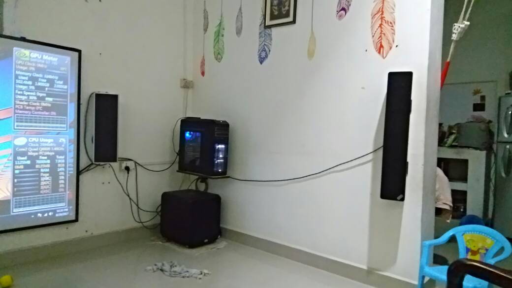

Did few more things to organize the living room with AV equipment..
Was using a pair of portable TV stand to hold the Klipsch BS until sometime back.. Since i changed the speakers, though to reuse the stands in a better way..
Rs 450/- per piece..
Removed the metal support and replaced with 12mm thick plywood to support PC cabinet dimensions..
Now the PC is wall mounted slightly above one of the subwoofer..
In similar fashion, made an other 12mm plywood to support AVR dimension, mounted slightly above an other sub..
Also made speaker brackets from scrap iron and painted them.. This gives the ability to tilt the front speaker (wall mounted) to listening position..
Front speakers..
