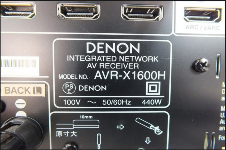

I am australia and I got a denon x1600h form Japanese and I am looking for a step down transofrmer for it.
The X1600H spec indicates 100V 50/60Hz 440W. So I mainly look for 500W ones. Correct me if I am wrong.

Your avr consumption is rated 440 w. It is always better to get a higher rated transformer. Are you going to run your AMP full volume? Don't think so. So the normal consumption of your avr will be lesser than 300w. A 600w rated converter should be safe enough for your avr running full blast.
Regarding ground loop, there are many causes for ground loop. Just by getting a isolation transformer may not prevent ground loop. An isolation transformer does provide safety in having a galvanic isolation of your equipment from the mains and can protect you from electric shock if a malfunction occurs in your avr. But remember that your avr too has safety capacitors inside. So chances of your avr malfunctioning and allowing live mains to get in contact with the metal body is very less.
I believe Australia has a good power supply. So chances of surges from the power supply would be minimal. Do you have frequent lightning in your area? You can also fit power strips which have surge protection and connect the step down to the power strip.
2400 watts sounds like a rip off.
+1
The ratings you see on electrical equipment is the continuous rating unless they specify the duty cycle. In places like Australia I don't think they'd fudge around.
As @mbhangui wrote unless you are going to add another 100V equipment go for the 600W. Ground loop will not be an issue since most a/v equipment are double insulated (the two squares you can see on that rating plate) and two pin plugs. It will come into play when you have multiple grounds running in the system through interconnects and ground wires from the amp, preamp, CDP, tape deck etc. running to different sockets. With a common power strip this will be more or less eliminated.
