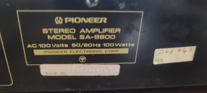

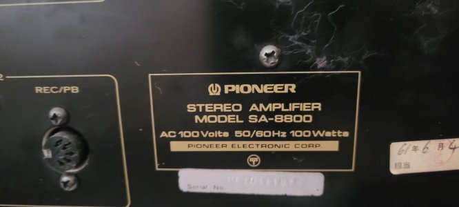

I imported a pioneer sa 8800 from Japan which step down converter is good...can anyone suggest a good one for indian use

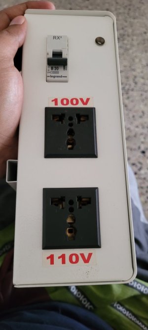

Look at that. Your device is designed for 50 / 60Hz. In Japan they have both 50Hz and 60Hz grid so they design their transformers to work on electrically the worst case i.e., 50Hz. Any good step down transformer would work.
Which socket must I use in india...100v r 110v
