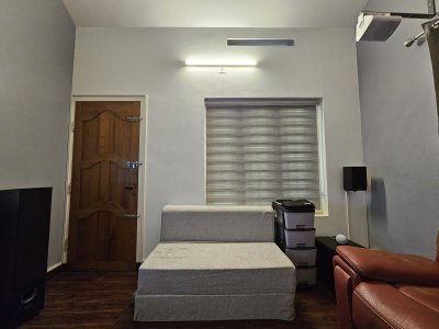

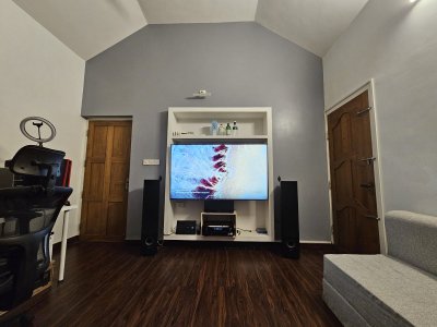

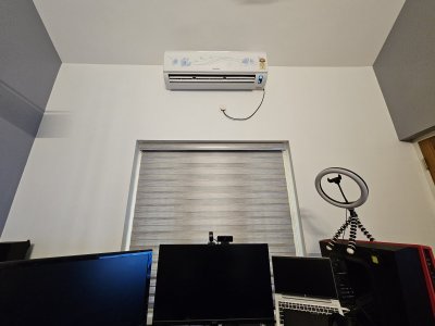

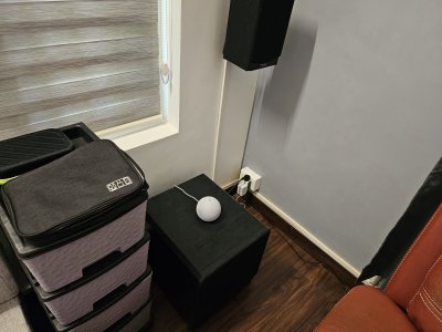

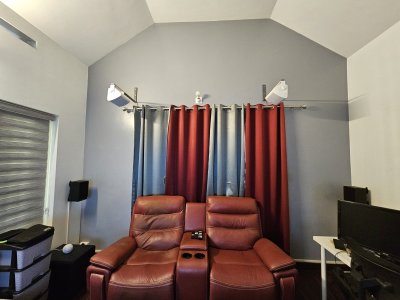

@prateekatasniya Sorry about the delay (was unwell over the weekend). I've attached my room's pics here.
1st pic - Front View
2nd pic - Rear View
3rd pic - Left side wall
4th pic - Right side wall
5th pic - Current subwoofer placement
For the "How loud do you listen?" question, the volume on my AVR is between 70 - 80.

Hey..
Here is the video on what's the first thing you must be doing to improve the audio quality in your room .
Appropriate seating placement will improve the bass quality significantly. :)
Rest of the details you can find in the video.

Hey @prateekatasniya Just watched the video! Thanks again 😀
I can put a gap of 2 feet between the rear wall and my recliner.
Some questions:
  • My rear surround speakers are currently positioned at 90 degrees so guessing I'll just need to pivot it slightly towards the MLP?
  • Any thoughts on my subwoofer placement? Where do I keep it after repositioning my recliner?
Some questions:
90° isn't the recommended angle.
Recommended angle is 110-120° . So after you move forward your speakers will fall at the appropriate angle.
You can try keeping the subwoofer behind the seat for even better tactile feel..
Check if you can localise the subwoofer. If you can then bring down the crossover frequency to 75hz or 70hz.
Good luck :)
Good luck :)
Remember - every change you make needs recalibration of the system.
