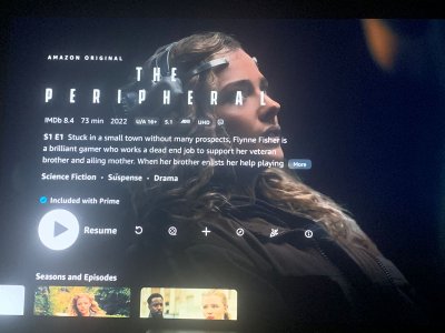

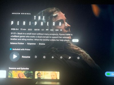

For me none of the contents are streaming HDR. Only getting uhd.1st image is from shield and 2nd is through tv app. Planning to get an Apple TV for ott and use shield only for kodi and local play back

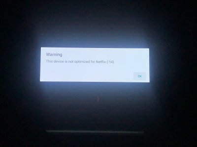

Dam it now same with Netflix as well. Both HDR and DV isn’t working. Also getting this pop up while re-installing the App
EDIT- Shield display settings changes to 4k 60hz automatically. Now set it to HDR and DV and all good. Just saved 17k. Was about to order the Apple TV 4K :)
This is right thing to do. If the display resolution on Shield goes back to default, you may not see the HDR or DV. I'd suggest keeping it at '4k 23.59hz/HDR and DV ready' that's the frame rate at which most of the movies are mastered/created and you get the best result off the shield.
