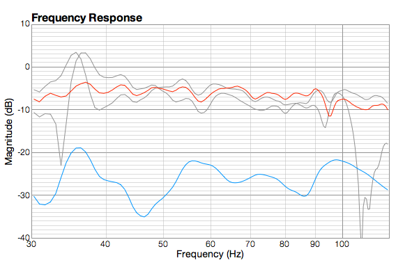

Here is what the frequency response looks like with a sub placed in the front of the room:
Red line is middle seat of sofa, grey lines are left and right seats of sofa. Ignore the blue line.
Here is what the frequency response looks like with a sub directly behind the sofa:
Not only is the frequency response smoother at the main seat (red line) but there is greater seat-to-seat consistency across the entire sofa (grey lines).
