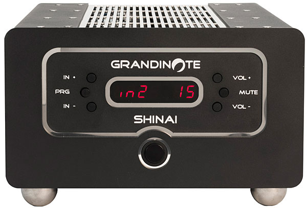

McIntosh and more recently Goldinote. Check a recent review of the Goldinote in Stereophile.
Please search Grandinote amplifiers
Yes it's Grandinote.
