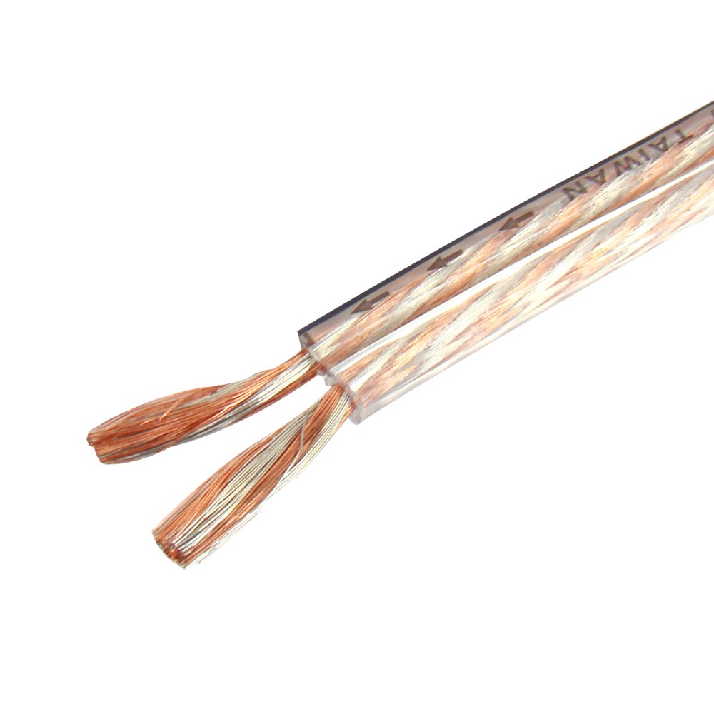

For speaker wire you can head to SP Road and goto MX Electronics which is on the left side from the main road. You get good quality speaker wire at about Rs. 100 per meter for a 14AWG. You can even order online at their store or amazon.
I've been using this and I'm very satisfied. image as below.
