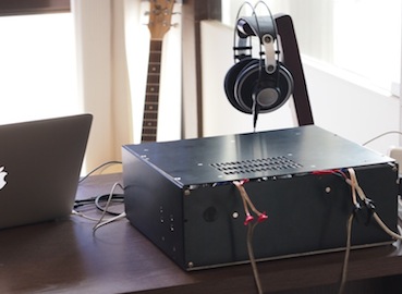

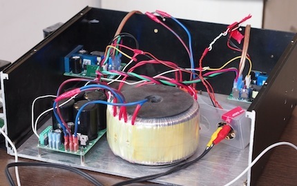

I put together a Hypex 400HG stereo amp last weekend in just a couple of hours. I have been listening to it all of this week at work connected directly to my macbook and it sounds fantastic. Can't wait to put it in a box and take it home for a proper listen.
lucky man! you can listen to your stereo at work!
Pls share more details about the build - where did you get the kit, casing etc. Some pics will help
I have a pair of really old B&O speakers which I got as a hand me down from my ex boss many years ago which serves me well at work :-)
I picked up the Hypex kit on my trip to Singapore a few months ago from a chap who never got started with the project and sold it to me brand new sealed boxes :-)
I paid around 30K INR for the Hypex Amp modules, Power Supply module and Softstart. Added a 500VA Toroid Transformer an old HTPC cabinet I had from many years ago to box it in. Finally, I need to add a Front Panel with an LED light, Holes in the back panel for XLR connectors, Speaker Binding post and power socket and switch and tidy up the internal wiring. Then take it home for a "proper" listen :-)
Here are some pics of the unfinished amp.
