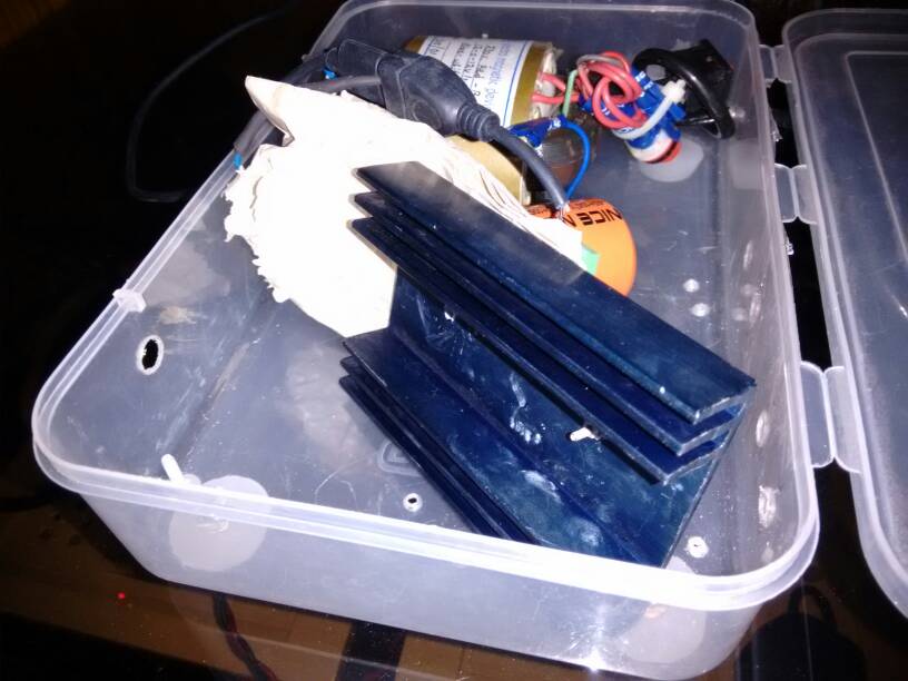

Just upgraded to lpsu for rpi. Things are going good.
