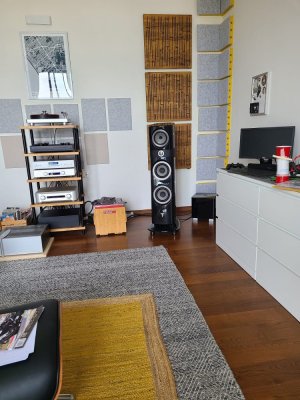

hello i just got a REL to add to my stereo setup. currently i have it placed in one corner behind my speakers towards the wall. i tried various placements but none that made much difference. The base notes are subtle and not gut punching. Is this what i should be expecting from an 8inch or is there gut punching base from this tiny 8" that i should be expecting.
Couple of pics

The only suggestion I can make here is to place the sub woofer beside your listening chair and listen. I know that running a cable all the way isn't ideal. If you have a spare long speaker cable lying around, give this a shot. This will be a high level input.
I would also suggest bringing the sub woofer forward. No use pushing it behind and into a corner. Try placing on the speaker outer and then inner, between your record storage box and the right loudspeaker. You can place the sub right beside the speaker. The feet of the REL an inch or two ahead of the Focal's spikes. I have my setup like this and it works very well.

The Focal Sopras go down to 34hz whereas the REL is rated to 32hz (-6db). You're not adding anything at all to your speakers with a T5x as the speakers are capable of reproducing the said frequencies.
To pair the T5x to your system, your best bet is:
(1) to dial down the crossover to the minimum allowed
(2) turn up the gain
(3) place them as close as possible to your listening position. If you're closer to the backwall, place it in the corner of the backwall instead of the front.
An even better bet is to get rid of the damn thing and buy something that extends lower.

You might need to experiment a bit with position. In my case (single T5/i) , its ideal position was along the right side wall, somewhat midway between the speakers and the seating position. In my room, there was more bass quantity in the corner behind the speakers (where REL advises us to start trying placement), but it was a bit too boomy and loud to my taste, and stood out too much.
DB1989's instructions above on blending the subwoofer in, are quite good!
Regardless of everything, a T5/x is meant for music only, and it will only augment the response of the speakers. There'll be quality bass, the kind that you don't know was there when the subwoofer is on, but will sorely miss when it's off. This is not even close to a brute-force-bass-response type subwoofer.
